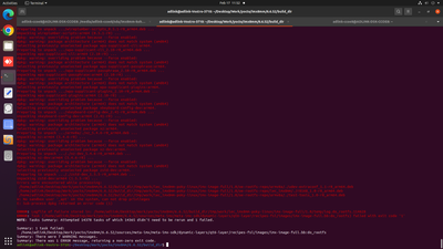

Hi ,
While trying to build the yocto image for imx8mm with scarthgap 6.6.52 support for our custom board , we have faced below error, how to solve?

danielchen
From the error message, "" No sandbox user '_apt' on the system, can not drop privileges",
I googled this and got lots of hits. You can refer to below suggestions.
Engelszüngeln: Fixing "No sandbox user" the Right Way
apt - No sandbox user '_apt' on the system, can not drop privileges - Ask Ubuntu

arka
Hi ,
followed the above link steps , still i could not able to solve the error
error:-
dpkg: warning: overriding problem because --force enabled:
dpkg: warning: package architecture (arm64) does not match system (amd64)
E: Sub-process dpkg returned an error code (1)

joanxie
how you build the 6.6.52 for imx8mm, which images and backed do you use? share the  build steps, let me reproduce this
