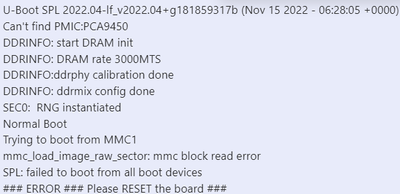

Hi Team,
I am trying to boot my board. but it won't Kindly find below error (Use kernel version 5.15)
I checked the hardware on 5.4.is able to boot but for same configuration 5.15 is not booting. I could not able to figure out issue. How to resolve this?

Hi @AMBh
Try to debug  mmc_load_image_raw_sector in common/spl/spl_mmc.c, find where this error return.
