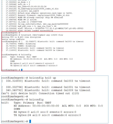

I try the Yocto3.3 version.
Wifi is work and test it pass.
But BT still cannot work.
I  get the some error message.
Bluetooth: hci0 : command 0x1001 tx timeout.
Bluetooth: hci0 : command 0x1009 tx timeout.

igorpadykov
Hi Charles
one can try to follow  UM11483  Getting Started with NXP-based Wireless Modules on i.MX 8M Quad EVK Running Linux OS - User manual (...
UM11490  Feature Configuration Guide for NXP-based Wireless Modules on i.MX 8M Quad EVK - User manual (public...
Driver is one, as described in  sect.4.13.4 Source Code Structure  i.MX Linux Reference Manual​
The NXP Onedriver source code files are available:
https://source.codeaurora.org/external/imx/mwifiex/tree/
