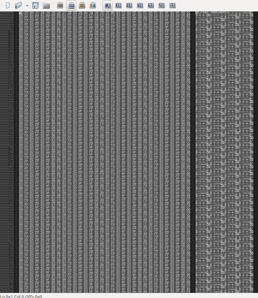

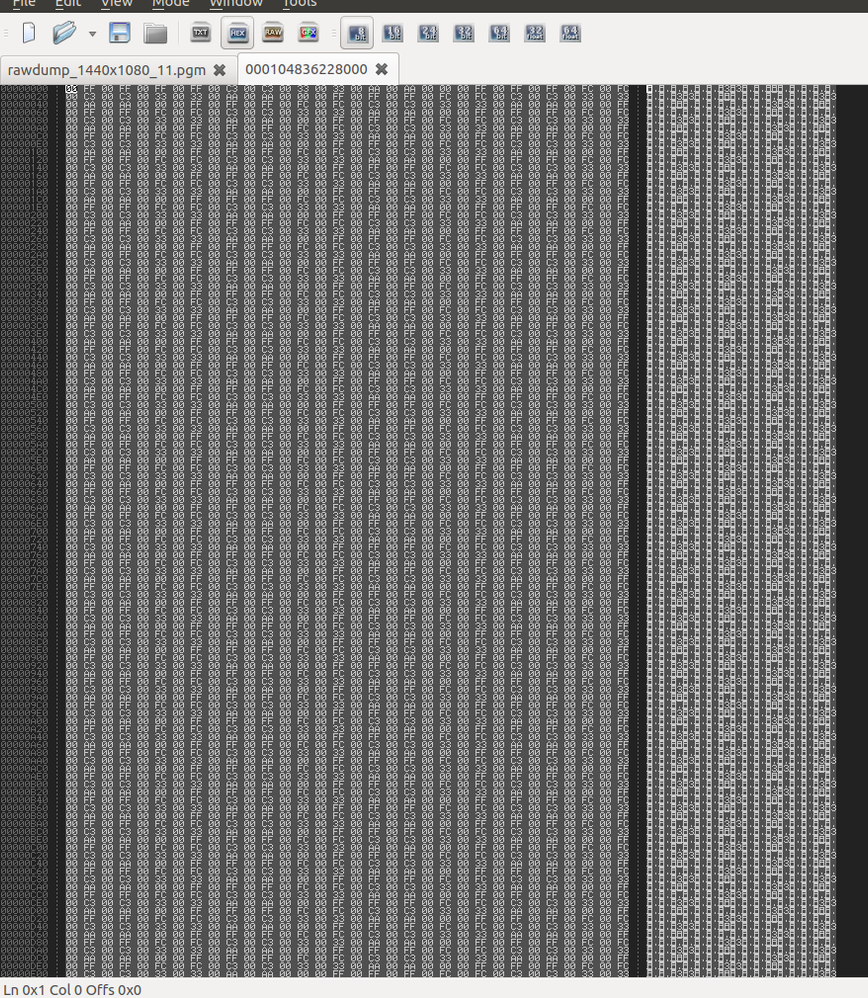

We then launched dual capturing with video_test in separate folder (to avoid that rawdump files with same name being overridden) and observed that :
1. If we launch both captures at nearly same time, there's only one that is able to dump the files out, other does NOT,
2. If we launch 1st capture then wait until it really captures (with rawdump_1440x1080_xy.pgm), then launch the 2nd capture (also with rawdump_1440x1080_xy.pgm in different folder) then 1st capture data starts to be truncated/shifted from 10 bit to 8 bit :
Valid data of 2nd capture :
Invalid data of 1st capture since the moment 2nd capture is launched (00 columns should <= 03, not always 00):
Therefore, I would like to know if there's any limitation of ISPs and/or of video_test utility with dual capturing regarding our resolution toward the size of DDR in our custom board and/or the default CMA memory in the system, please ?

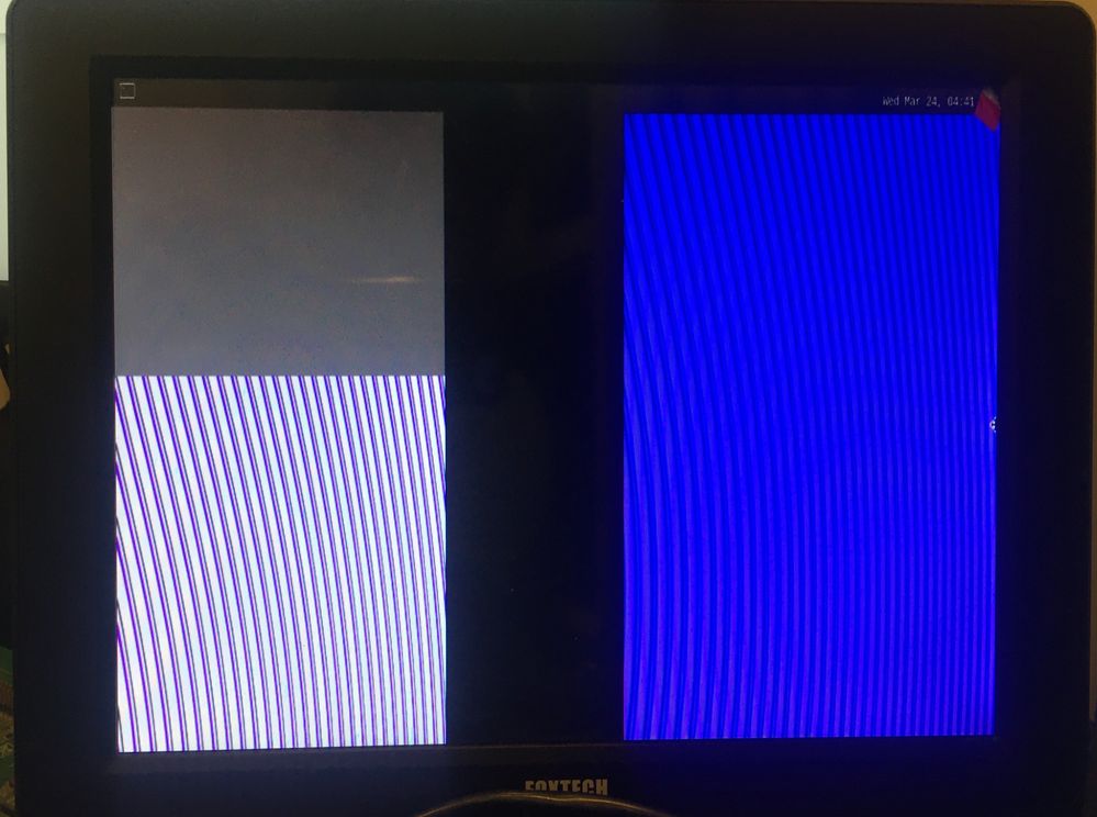

Hi @joanxie,
The same phenomenon (difference in brightness/color) also happens on same display :
The 2 instances of our  ISP driver share everything from XML to .json.
We also tested on more recent BSP (5.10.52-2.1.0) release and observed the same thing : Lately launched streaming is brighter and makes the formerly launched streaming darker. More illustration is in following links
1. cam0(/dev/video2) before cam1 (/dev/video3) : https://drive.google.com/file/d/15bAhZcY6-YArsLZY2KlLv9BvKxarGGaw/view?usp=sharing
2. cam1 (/dev/video3) before cam0 (/dev/video2) : https://drive.google.com/file/d/1mluJeyFnvp8SJozEfaMsajTUi3dg6rcD/view?usp=sharing
We also output same test pattern from both sensors to avoid the dependency of external condition (light, lens).

To update the situation, I did 2 tests with 2 physical displays :
1. In the 1st test, I launched gst-launch-1.0 -v v4l2src device=/dev/video0 ! waylandsink for cam0 in smaller display first then gst-launch-1.0 -v v4l2src device=/dev/video1 ! waylandsink for cam1 in bigger display later : https://drive.google.com/file/d/1MaGugWX7-DRBvFiecD-BHZTlmMmd6C42/view?usp=sharing
2. In the 2nd test, I changed the camera streaming's order by launching gst-launch-1.0 -v v4l2src device=/dev/video1 ! waylandsink for cam1 in bigger display first then gst-launch-1.0 -v v4l2src device=/dev/video0 ! waylandsink for cam0 in smaller display later : https://drive.google.com/file/d/1ITv7wQPzavTaCC9Lphod_oBugAWLEQp3/view?usp=sharing
My observation is that the later GST launching/streaming impacts the former one which was initially good (i.e. in the videos the later makes the former turn blue or darker visually) and this seems to be an issue of ISP.
@joanxie, @Bio_TICFSL  : Would this be a known issue and if YES, has there's been any solution in more recent release(s), please ?
Khang.
