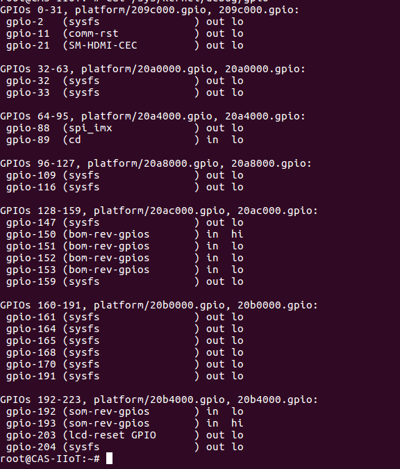

I have to integrate murata wifi module using sdio interface for which the gpio pin number 33 and 116 has to be low during bootup.

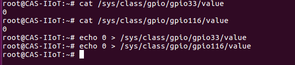

I have tried the make them low in the following manner
I checked the status of gpios. I can see 33 and 116 are set to low
But after rebooting it and again I checked the status. Those pins are not present.
I checked those pins using multimeter, they are still high.
How can I make them low during boot up.

pins state is not retained  after rebooting, it is set to values described in
Table 97. 21 x 21 mm Functional Contact Assignments, column "Out of Reset Condition"
i.MX 6Solo/6DualLite Applications Processors for Consumer Products

>How can I make them low?
there is no way to change it after reset, as it is defined in hardware.
One can set necessary value for example in uboot/

alam1
I made them low from uboot.
But the issue is its still high after reboot.
I checked it with multimeter.
I want to the pins to low during bootup and then get high.
Is this possible??

no this is not possible as it is defined in hardware.
