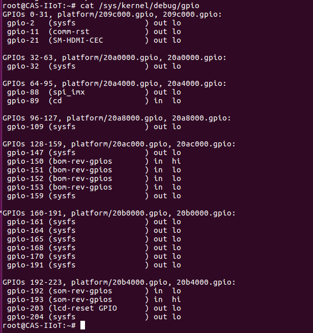

I am new to embedded system.
I am using i.mx6dl on a custom board running ubuntu 16.04.
Linux kernel: 4.1.15
I have to integrate murata wifi module using sdio interface for which the gpio pin number 33 and 116 has to be low during bootup.
I have tried the make them low in the following manner
I checked the status of gpios. I can see 33 and 116 are set to low
But after rebooting it and again I checked the status. Those pins are not present.
I checked those pins using multimeter, they are still high.
How can I make them low during boot up.

Hi alam1
pins state is not retained  after rebooting, it is set to values described in
Table 97. 21 x 21 mm Functional Contact Assignments, column "Out of Reset Condition"
i.MX 6Solo/6DualLite Applications Processors for Consumer Products

Hi igor
I checked the table which you have mentioned.
The pins are set to high.
How can I make them low?
I tried to make low from uboot, still the problem is not solved.
there is no way to change it after reset, as it is defined in hardware.
One can set necessary value for example in uboot/

alam1
I made them low from uboot.
But the issue is its still high after reboot.
I checked it with multimeter.
I want to the pins to low during bootup and then get high.
Is this possible??

no this is not possible as it is defined in hardware.
