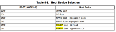

Regarding issues booting from FSPI please double check the boot mode:
Also, double check that when flashing with UUU, your device is in serial download mode. It'd be of great help if you could provide more details about possible failure during flashing process in order to further troubleshoot this issue. I'd also recommend (if you haven't checked them out before) reviewing the Reference Manual for the 8QXP (Section 5.8.3 FlexSPI serial flash memory boot, and subsequent sections).
