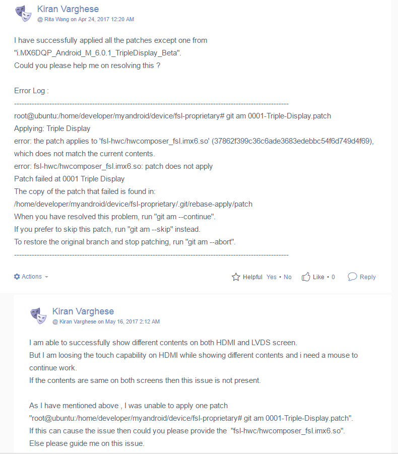

I am working on "iMX6Q SABRE-AI" running "Android Marshmallow" with dual display(HDMI and LVDS).
I wanted to show different contents of HDMI and LVDS and I am able to do with the help of patch received from NXP.
Link : Dual display on imx6 android
But when different contents are shown(using WindowManager API) , I am loosing the "touch" feature in HDMI and I need to use a mouse to work.
If same content is shown on both displays then this issue is not present.
Any Suggestions ?

Just for your information , i did applied a patch received from NXP for showing different contents on multiple displays.
From that patch i was not able to apply one lib change - please refer this thread Dual display on imx6 android.
Screenshot below :
May be this is causing the touch issue , am not sure ?
If i can get the modified lib (hwcomposer_fsl_imx6.so), then i can try and reply.

I had received Triple Display application from NXP and in that application also touch is not working.
Can any one provide help on this ?
