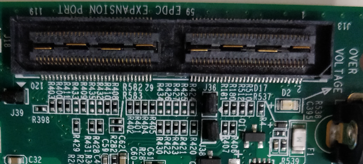

I am trying to test touch input support for the E-INK Panel i.e IMXEBOOKDC4 that is  connected to my IMX7D sabre SDB board, but unfortunately the ELAN touch driver is failing to probe the device. The DTB used for booting is "imx7d-sdb-reva-epdc.dtb"
Error noticed:
elan-touch 2-0010: elan - Read Hello Packet Failed
elan-touch: probe of 2-0010 failed with error -5
Am I missing something here ? Is ELAN_TS appropriate touch driver for this display ? I can see the display coming up fine with OE splash, but the touch isn't working.

Hi Srikant
please try board rev.C or later, as on rev.A board connector J13 there are no touch signals TOUCH_GPIO,TOUCH_CE,
they were added on later board revisions. One can check J36-39 on i.MX7D SDB rec.C board.
igor

igorpadykov
Hi srikanth
kernel 4.1.15 has elan_ts configuration, please enable this flag to have elan touch enabled.
/arch/arm/configs/imx_v7_android_defconfig
+CONFIG_TOUCHSCREEN_ELAN_TS=y
igor

I now have this i.MX7D board that has J36, J38 and J39 pins on them, but the result is still unchanged. Please see the image attached.
Should we test with jumpers (J36, J38, J39)  in-place or remove them for touch functionality ?

Thanks for the response! In this case I am assuming imx7d-sdb-reva-epdc.dtb  does not serve any purpose w.r.t touch support on imx7d-sdb rev.A board.
Technically i.MX7D Sabre SDB Rev. A board does not support touch support on E-INK (IMXEBOOKDC4) panel due to hardware limitation. If this is true, then I am resolving this discussion.
Thank you so much for followup and responses.
