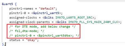

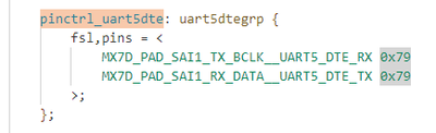

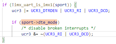

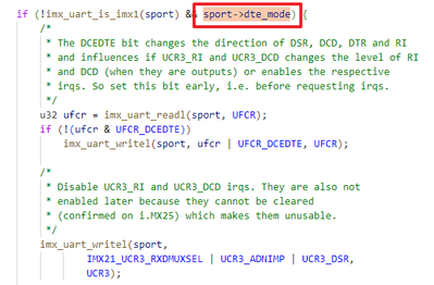

Zhiming_Liu
This is reference setting for using DTE , please refer the kernel driver and dts.
Zhiming_Liu_0-1701737893293.pngZhiming_Liu_1-1701737930101.pngZhiming_Liu_2-1701737940999.pngZhiming_Liu_3-1701737966020.png
