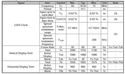

I'm trying to set timings of the lcd AM-19201080D1TZQW-T02H in order to connect display to an embedded board with IMX8MP processor.
I customized device tree node with the following values, read in the display specification:

With these configuration display does not work. Sometimes display turn on with only a green backlight.
The timing specifications are:
What am I doing wrong?
Can you help me?

Hi @Destel
1.hactive should be 1920, the other horizontal parameters should be double.
2.You need add new PLL RATE in imx_pll1443x_tbl, PLL VALUE=PIXEL CLOCK *7 (dual channel mode)

I don't think it's a pll rate problem. I modified timing values  with the following suggested by supplier:

Now monitor is working, but flickering problem on monitor still remain. Maybe some settings are wrong?
Can you help me?
