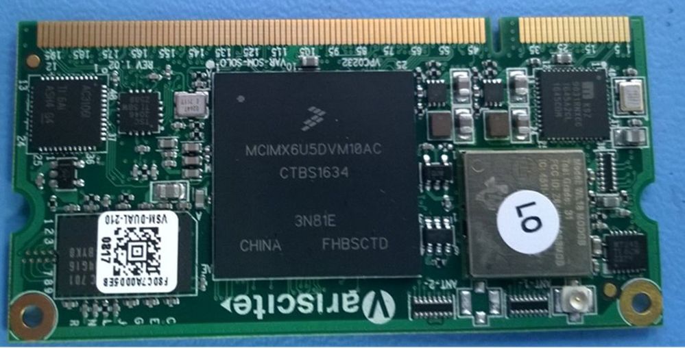

I have a module that is using the i.Mx6 processor.   If I run the processor at my desk with a app that uses 25% cpu (used Top app to get this number)  and check the temperature of the case it is 44C (temperature varies across the lid).  The internal temperature is around 60C (cat /sys/class/thermal/thermal_zone0/temp ).
So if I had the junction the Case number I could figure out roughly how many watts my processor is using at a 25% load.  Also is there any linux app that will show me GPU load?

Hi Tom
for Junction to Case coefficient one can check  Table 7. Thermal Resistance Data
http://www.nxp.com/docs/en/data-sheet/IMX6SDLCEC.pdf
AN4579 i.MX6 Series Thermal Management Guidelines
http://cache.nxp.com/docs/en/application-note/AN4579.pdf
for gpu one can look at

Looking at Table 7 it list various thermal items.
Junction to Board = 14 C/W,         Junction to Case = 6 C/W    Junction to Package top = 2 C/W...
Not sure how to apply these items....
So in my test of internal temp = 60 and top of BGA = 44
1. Is the top of the bga package consider the Case?
2. Since I see a delta for about 15 C between internal and top does that means the processor is doing over 2 watts????
    This seems unlikely since I am only loading the cpu at 25 % with a simple app that is reading the serial port and scrolling the received HEX data on the screen.  So I am guessing, I am misunderstanding how to use these numbers.
