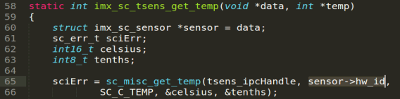

Q2. Linux BSP is able to chose SC_R_PMIC_0, SC_R_PMIC_1 and SC_R_PMIC_2 for resource parameter.
Which module's temperature can I get by specifying these resources?
Copy from linux_4.14.98_2.3.0_ga/drivers/thermal/imx_sc_thermal.c

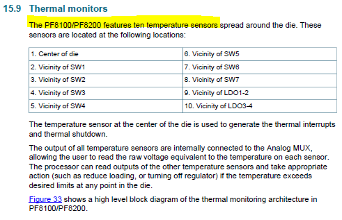

Let me confirm once again. What is different SC_R_PMIC_0, SC_R_PMIC_1 and SC_R_PMIC_2?

PF8100 has ten temperature sensors. Which sensor temperature can be acquired by selecting SC_R_PMIC_0?
Also, I would to know about SC_R_PMIC_1 and SC_R_PMIC_2.
Kazuma Sasaki.
3,750 Views
igorpadykov
1. Center of die
and so on.
igor

What is the difference between SC_R_PMIC_0, SC_R_PMIC_1 and SC_R_PMIC_2?
Before you told me that these settings will be return the temperature of center of die.
How should I use these settings properly?
MEK has one PMIC. At that case, can we select SC_R_PMIC_1 and SC_R_PMIC_2?
