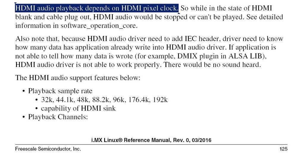

I have a customized imx6dl sabresd board(Android4.2.2)。
I refered to imx6dl HDMI can't support 1024x768 ,  and now I can get 1024 x768 resolution through HDMI。
But there is no HDMI sound output when I choose 1024x768。
(If I choose 720p,There is sound output through HDMI)
I want to know why, and how to fix it?

Hi Jiang
strictly speaking 1024x768 is not supported by HDMI module
according to sect.33.4.3 Supported Video Mode i.MX6DQ Reference Manual
http://cache.nxp.com/files/soft_dev_tools/doc/support_info/iMX6DQPRM.pdf
So there may be issues with audio, as HDMI audio playback depends on HDMI pixel clock.

mike_susen
Hi Jiang,
please see this document HDMI Audio Setting
Michal
