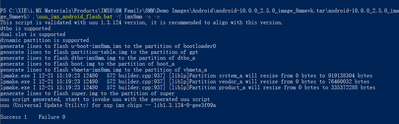

joanxie
I have tested on my imx8mm lpddr4 evk board successfully, pls see the screenshot as below:
I tested on my win10 PC, and I tested uuu 1.3.124 version and 1.4.43 version
