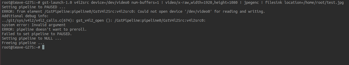

The following command is run in terminal to capture an image from the camera. The linux image has GStreamer Core Library version 1.18.0
gst-launch-1.0 v4l2src device=/dev/video0 num-buffers=1 ! video/x-raw,width=1920,height=1080 ! jpegenc ! filesink location=/home/root/test.jpg
However, we are getting the error below as shown in the image below.

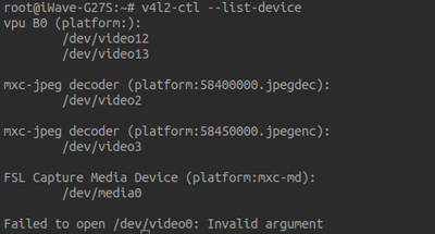

joanxie
use the command "v4l2-ctl --list-device" to check if your camera uses /dev/video0 or other device, it seems you use the wrong device

KartikFromMarth
In the screenshot below, I'm able to see the devices by running the command "v4l2-ctl --list-device".
Although I used the above device to capture an image, I am still experiencing errors

joanxie
it seems that your board couldn't probe the camera yet, pls share the whole logfile with me
