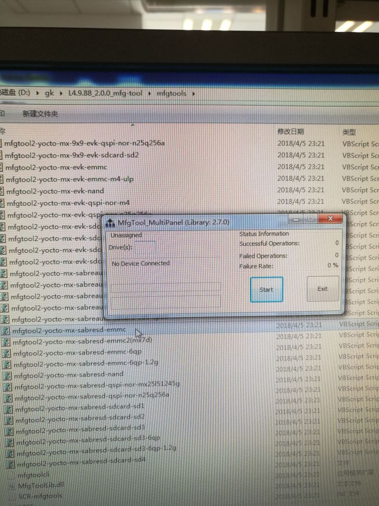

Hello everyone:
We have a development board MCIMX6QP-SDB. And we need to program EMMC.
According to the instructions, we use L4.9.88 mfgtools. However, this version of mfgtools can not recognize board.
The following is running screenshots.

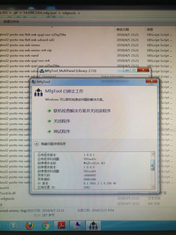

And report an error when we send electricity to the board.
The following is error screenshots.

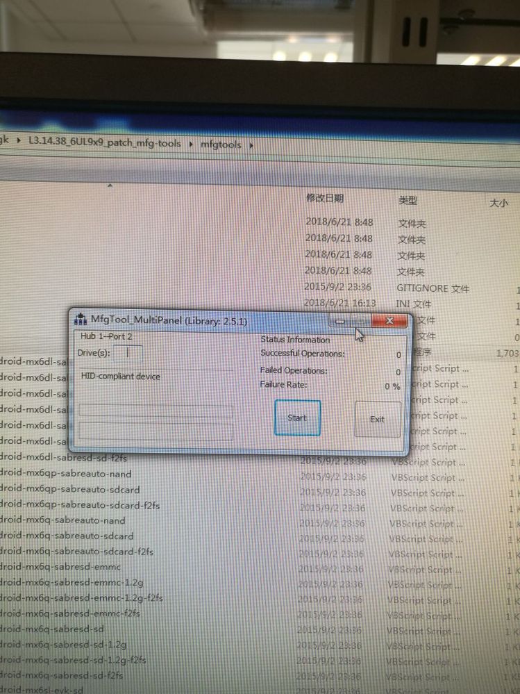

If we use l3.14.38.6ul verson of mfgtools,  it could recognize board. But when the program EMMC into second step, our board can not be recognized.The following is the screenshots of l3.14.38 mfgtools in second step.

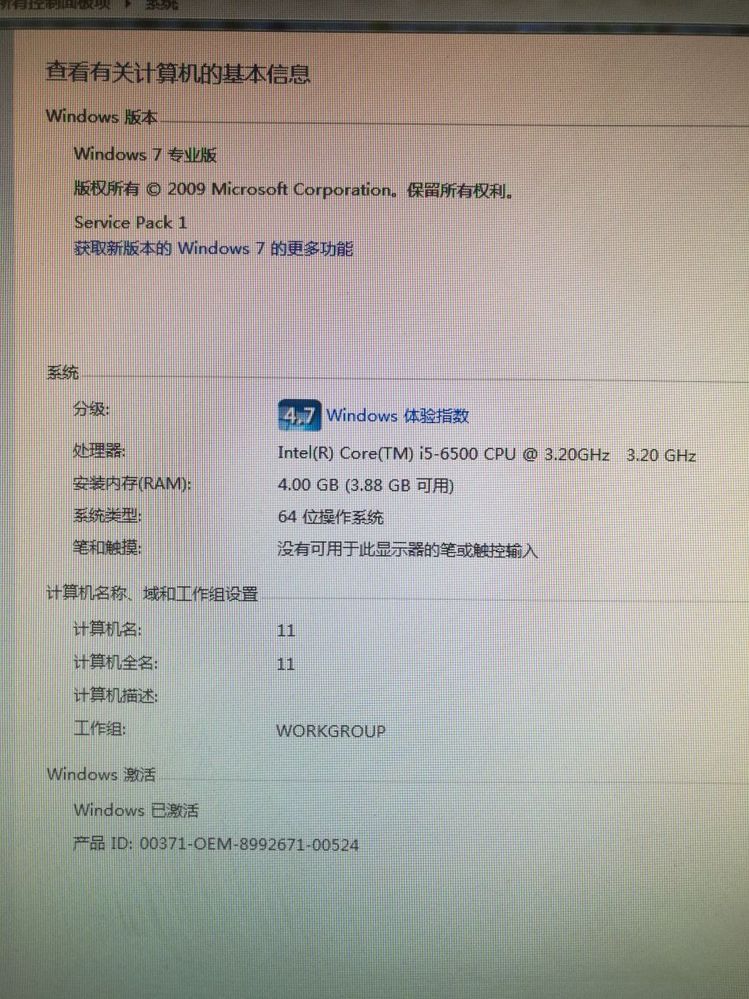

Our host environment is WIN7. The following is the screenshots of host environment.

Have you the i.MX6 HID driver properly installed on your host PC? Please check.
Also, please try the earlier MFGtools version, e.g. 4.9.11 or 4.1.15.
