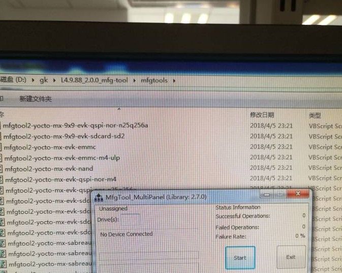

We have a development board MCIMX6QP-SDB. And we need to program EMMC.
According to the instructions, we use L4.9.88 mfgtools. However, this version of mfgtools can not recognize board.
The following is running screenshots.

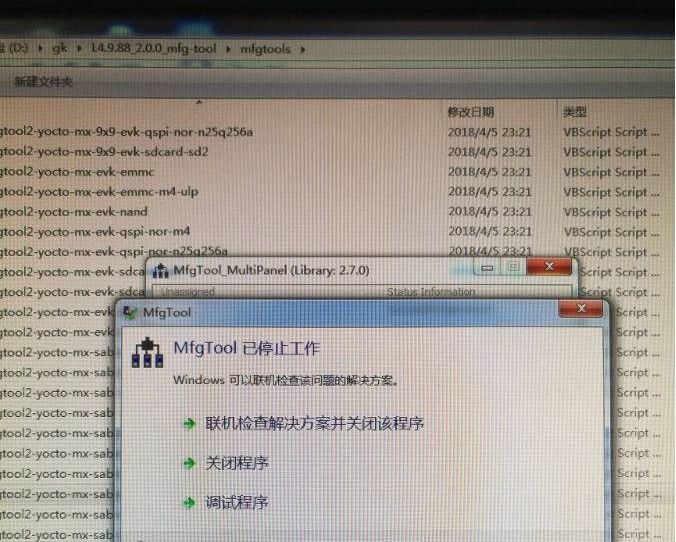

And report an error when we send electricity to the board.
The following is error screenshots.

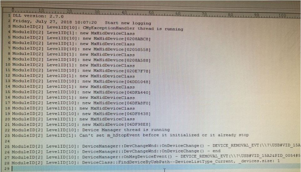

The following is the log of mfgtools.

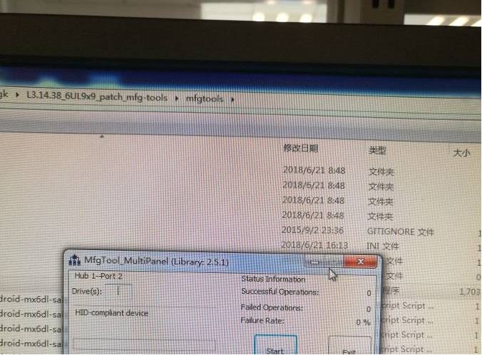

If we use l3.14.38.6ul verson of mfgtools,  it could recognize board. But when the program EMMC into second step, our board can not be recognized.The following is the screenshots of l3.14.38 mfgtools in second step.

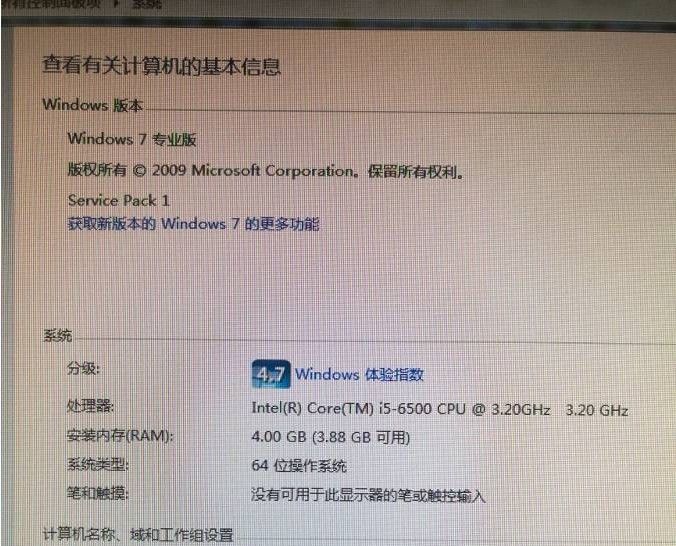

Our host environment is WIN7. The following is the screenshots of host environment.
And we do not think it is related to the driver on the host. Because in the host, the HID device could be recognited in Device manager.
In addition we noticed that the library version  of mfgtools(l3.14.38) which could recognize board is 2.5.1.
And the library version of mfgtools(4.9.88 and 4.9.11)which could not recognize board is 2.7.0.
Is this related to our problems?

when you use mfgtool 4.9.88 version, which file do you open? do you open MfgTool2.exe or any *.vbs file?
first, when you connect PC to board, if your PC can recognize the board, the mfgtool can recognize it too. so I think maybe you open the wrong file, you can try to use MfgTool2.exe or mfgtool2-yocto-mx-sabresd-emmc-6qp.vbs

We used the file "MfgTool2.exe" and "*.vbs". In fact, the picture which I put in the post is the case of using these two files.
 And we just want to program EMMC, and any version of MfgTool2 we can accept.
But we have used some different version of MfgTool2 (3.14.384.9.88, 4.9.11). But they can not program EMMC, and problem is not the same.
So please give us a way to program EMMC.

I can open mfgtool in 4.9.11 and 4.9.88, so I asked you which detailed file you open when you use 4.9.88?

Well, we used "MfgTool2.exe" and "*.vbs" files. I will give the image of file later.
