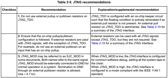

Dear,
1,As the above table said, if I don't want use JTAG function, should the JTAG_MOD pin be connected with pull-up resistance? what is the resistance ?
2,I also find there are three different JTAG security modes:
     Mode #1: No Debug-Maximum Security.
     Mode #2: Secure JTAG-High security.
     Mode #3: JTAG Enabled-Low security.
I am puzzled about these. I think the JTAG security modes only can be select by burning the related e-fuses if the JTAG_MOD pin is connected to GND.
If we connect the  JTAG_MOD pin with pull-up resistance, we can not select the mode. Is my understanding right?
If I don't want to use JTAG function, which method will be recommended?
Thank you~!

if JTAG function is not used at all you can just leave it unconnected

Hi 王 剑翰
you can connect JTAG_MOD pin to ground if JTAG function
is not used. For bsdl testing JTAG_MOD should be high.
JTAG security modes implies:
No Debug-Maximum Securit - jtag just disabled
Secure JTAG-High security.- access with secret patterns
JTAG Enabled-Low security - usual jtag usage

Hi igor,
Thank you for your quickly answer.
As the table says, I think connecting JTAG_MOD pin to pull-up resistance is also used for no JTAG debug function. Am I right?
I think the difference between JTAG_MOD=0 and JTAG_MOD=1 is chain length.
No matter we set JTAG_MOD=0 or JTAG_MOD=1, the boundary scan test can be used.
So I think there are two method for no JTAG function:
1) Connect JTAG_MOD pin to ground and then burn the related e-fuses to enter No Debug-Maximum Securit mode;
2) Connect JTAG_MOD pin to pull-up resistance, so that we don't need to care the related e-fuses;
Above is my understanding, could you kindly correct me if I am wrong?

Thank you for your answer. I think I understand it.
