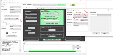

@yalin
Thank you for your reply.
Do you mind sharing the steps to obtain the dcd.bin and flash with any of the two tools? I am using mcubootutility here, I added the project file to load .hex or .axf.
I cant seem to find a way to generate the dcd.bin.
2,758件の閲覧回数
yalin
Hi @TM_MI
I never generate a dcd.bin, I just modify the DCD configuration table in MCUXpresso IDE and update the code, and the modification will be seen in board/dcd.c, then build the project as usually. You can flash the generated .axf file to board by MCUBootUtility directly without configurating the dcd.bin in it.
