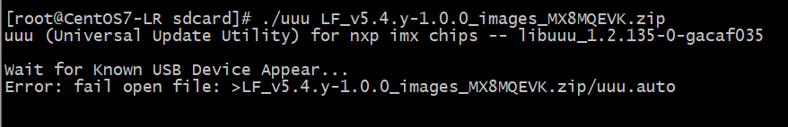

I download the 5.4.3 linux version with imx8mq board "LF_v5.4.y-1.0.0_images_MX8MQEVK.zip"in the blew link :
Linux L4.14.98_2.0.0_GA; SDK2.5.2_8QXP/8QM_PostGA, SDK2.5.1_7ULP_GA3 Release Announcement
But when I used the uuu tools flash it to emmc, It says error as blew:
Is there any way to download linux 5.4.3 demo image for i.mx8mqEVK?
Thanks~

the link you sent is for 4.14.98, for 5.4.3, you can download from the link as below:
Embedded Linux for i.MX Applications Processors | NXP ”
focus on the "L5.4.3_1.0.0_MX8MQ"
