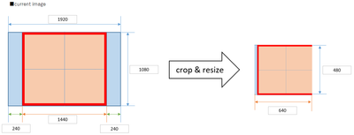

I'm using Linux kernel version 6.1.22 built with yocto on an imx8mp processor.
When I cropped and resized using gstreamer's v4l2src element, the desired image was not output.
<Cropping & resizing parameters>
Cropping cuts out 240 pixels on the left and 240 pixels on the right.
Resize reduces 1440 x 1080 to 640 x 480.
<gstreamer pipeline>
gst-launch-1.0 v4l2src device=/dev/video2 crop-left=240 crop-right=240 num-buffers=30 ! "video/x-raw,width=640,height=480" ! jpegenc ! multifilesink location=/tmp/%02d.jpeg

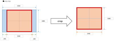

The cropping range is normal when only cropping is performed.
gst-launch-1.0 v4l2src device=/dev/video2 crop-left=240 crop-right=240 num-buffers=30 ! "video/x-raw" ! jpegenc ! multifilesink location=/tmp/%02d.jpeg
Why does the cropping range become strange when resizing is performed at the same time?
