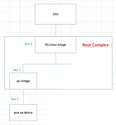

Dear sir
We use the "SECO TrizepsVIII-Mini"(IMX8MM) CPU for  Windows 10 IoT enterprise.
We try to add a PCI device by Ti XIO2001a , but the UEFI of Windows 10 IoT enterprise OS can not read it.
But, If we use the same hardware by reinstall the Linux OS, we can read the PCI device at the PCI Bus2 well before PCIE to PCI bridge(XIO2001a , PCIe bus1) .
Like this: IMX8MM PCIE pin->PCIE bridge(bus0)->PCIE to PCI bridge(bus1)->PCI fpga chip(Bus2)
We chceck the UEFI code of PCEI(iMX8PciExpress.c) in the NXP BSP of "mu_platform_nxp" folder.
(.\mu_platform_nxp\Silicon\ARM\NXP\iMX8Pkg\Drivers\PciExpress\iMX8PciExpress.c)
and Trizeps8mini_2GB.dsc file.
We make sure the UEFI code of PCEI for IMX8MM donot support the giMX8TokenSpaceGuid.PcdPcie1SwitchSupport.(Only support to read the PCIE BUS0,BUS1)
I try to use the IMX8MQ PCIE Config Base address setting to "Trizeps8mini_2GB.dsc"(IMX8MM)

But I still only can read the PCIE to PCI device(XIO2000a), can not read the PCI device in the BUS2

iMX8PCIe: PCIe0 configured with internal reference clock.
iMX8PCIe: IOMUXC_GPR_GPR14 0x4B4C9400
iMX8PCIe: PCIe0 Link speed change failed!
iMX8PCIe: PCIe0 Link up, Gen speed: 1
iMX8PCIe: Scanning device B: 00 00 F: 00
iMX8PCIe: PcieGetPciConfigAddress-->BusNumber == 0 && DevNumber == 0,B0,D0,address=0x33800000
iMX8PCIe: 2PciePciRead====VendorId0===0x16C3,address=0x33800000,B=0,D=0
iMX8PCIe: 2PciePciRead====VendorId1===0x16C3
iMX8PCIe: 2PciePciRead====DeviceId===0xABCD
iMX8PCIe: 2PciePciRead====CacheLineSize===0x0
iMX8PCIe: 2PciePciRead====LatencyTimer===0x0
iMX8PCIe: 2PciePciRead====HeaderType===0x1
iMX8PCIe: 2PciePciRead====BIST===0x0
iMX8PCIe: Configuring B:00 D:00 F:00
iMX8PCIe: 1111 IS_PCI_BRIDGE=======01
iMX8PCIe: Pci Bridge to set pcie package
iMX8PCIe: Pci Synopsys set reg ++++++++++++++++++++++++++++++++++++++++++++++++++++++
iMX8PCIe: PCI_COMMAND_OFFSET 0x4 red reg=0x507
iMX8PCIe: PCI_COMMAND_OFFSET 0x4 write reg=0x507
iMX8PCIe: Current memory resource 0x19000000 Size 0x06F00000
iMX8PCIe: Scanning device B: 01 00 F: 00
iMX8PCIe: PcieGetPciConfigAddress-->BusNumber == 1 && DevNumber == 0,B1,D0,address=0x1FF00000
iMX8PCIe: 2PciePciRead====VendorId0===0x104C,address=0x1FF00000,B=1,D=0
iMX8PCIe: 2PciePciRead====VendorId1===0x104C
iMX8PCIe: 2PciePciRead====DeviceId===0x8240
iMX8PCIe: Configuring B:01 D:00 F:00
iMX8PCIe: XIO2001 set reg ++++++++++++++++++++++++++++++++++++++++++++++++++++++
iMX8PCIe: XIO2001 set reg ------------------------------------------------------
iMX8PCIe: PCI_COMMAND_OFFSET 0x4 red reg=0x0
iMX8PCIe: PCI_COMMAND_OFFSET 0x4 write reg=0x6
iMX8PCIe: Scanning device B: 02 00 F: 00
iMX8PCIeiMX8PCIe: 2PciePciRead====VendorId0===0xFFFF,address=0x18000000,B=2,D=0
iMX8PCIe: PcieDevicePresent PciDevice->Hdr.VendorId=0xffff No Pcie device found B=2,D=0
iMX8PCIe: PcieSimpleScanBusAndAssignResource-->No Pci device found
iMX8PCIe: Allocating memory resource 0x19000000 size 0x00100000
iMX8PCIe: Current memory resource 0x19100000 Size 0x06E00000
iMX8PCIe: Scanning device B: 01 01 F: 00
iMX8PCIe: PcieGetPciConfigAddress false at --Bus1,D1,F0-MaxBusNumber15-----
iMX8PCIe: Allocating memory resource 0x19100000 size 0x00100000
iMX8PCIe: Current memory resource 0x19200000 Size 0x06D00000
iMX8PCIe: Scanning device B: 00 01 F: 00
iMX8PCIe: PcieGetPciConfigAddress false at --Bus0,D1,F0-MaxBusNumber15-----
iMX8PCIe: ===============================
iMX8PCIe: Root Complex Configuration space address 0x33800000,bus0,dev0
iMX8PCIe: PCI [00] 0xABCD16C3 0x00100507 0x06040001 0x00010000
iMX8PCIe: PCI [10] 0x18000000 0x00000000 0x00010100 0x20001010
iMX8PCIe: PCI [20] 0x19101900 0x0000FFF0 0x00000000 0x00000000
iMX8PCIe: PCI [30] 0x00000000 0x00000040 0x00000000 0x000201DF
iMX8PCIe: PCI [40] 0xDBC35001 0x00000000 0x00000000 0x00000000
iMX8PCIe: PCI [50] 0x01817005 0xBB954000 0x00000000 0x00000000
iMX8PCIe: PCI [60] 0x00000000 0x00000000 0x00000000 0x00000000
iMX8PCIe: PCI [70] 0x00420010 0x00008000 0x0010201F 0x0073CC12
iMX8PCIe: PCI [80] 0x30110040 0x00000000 0x004003C0 0x00010018
iMX8PCIe: PCI [90] 0x00000000 0x0000041F 0x00000000 0x00000006
iMX8PCIe: PCI [A0] 0x00010002 0x00000000 0x00000000 0x00000000
iMX8PCIe: PCI [B0] 0x00000000 0x00000000 0x00000000 0x00000000
iMX8PCIe: PCI [C0] 0x00000000 0x00000000 0x00000000 0x00000000
iMX8PCIe: PCI [D0] 0x00000000 0x00000000 0x00000000 0x00000000
iMX8PCIe: PCI [E0] 0x00000000 0x00000000 0x00000000 0x00000000
iMX8PCIe: PCI [F0] 0x00000000 0x00000000 0x00000000 0x00000000
iMX8PCIe: ----------------------------------
iMX8PCIe: Device Configuration space 0x1FF00000,bus1,dev0

How can I do to fix the problem.
Download the SECO uefi code at:
https://drive.google.com/file/d/1w0Sch16-pna1udHr7uvpUeMGo1zkHg6f/view?usp=drive_link
The zip file seco_uefi_code_mu_platform_nxp.zip have two folder:
mu_platform_nxp ->Add the pcie switch function to "Trizeps8mini_2GB"
mu_platform_nxp_org -> seco org uefi code only support pcie bus0,1
buildme64.sh ->firmware " "Trizeps8mini_2GB"" building command file.
We build the the firmwae file "firmware.tr8m.bin" by command " /buildme64.sh -b Tr8m -t all"
