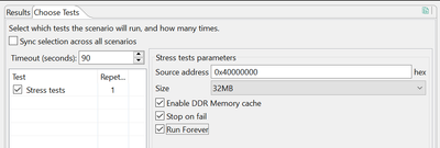

i have installed config Tools for i.MX v14 and v15.
i can run the DDR Stress test, but the help looks different than the tool.
accourding to the help i can set a test duration, in the tool i only have a "run forever".
See attachement where on the left is the tool, on the right is the Help.
if i select run forever i can only cancel the test, what restults in a "skipped" as result, but I would need a log file.
I an also not change number in the "Repitition" column.
Does anybody has an idea how to get the Test duration entry?

Hello, I hope you are doing well.
It seems that the documentation was made with an older software version and have not been updated yet.
Could you please share me the steps you followed to replicate the error?
Best regards.

hermann_ruckerb
Hello Jorge,
I checked and seem the same behavior in v14.
will work on trying to reporoduce the error message. Most likely something like starting the test, cancel it and next run fails.
BUT: this is not my main focus for this questions ..there is a workaround for this (restart the tool).
Main Question is:
How to do a Stress test and document PASS or FAIL?
I can "run forever", but i then can only click "cancel" and then the log says "skipped".. so not documentation possible
Hermann

JorgeCas
That is true, when you mark "Run forever" option and stop the test, will skip logs and it is not possible to get the results.
Some kind of workaround is mark the option "Stop on fail" and let test running.
To stop it, just turn off the board or disconnect USB cable from PC.
I attached the log I got using this "method".
Best regards.
