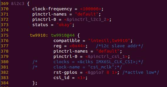

  I revised device tree.

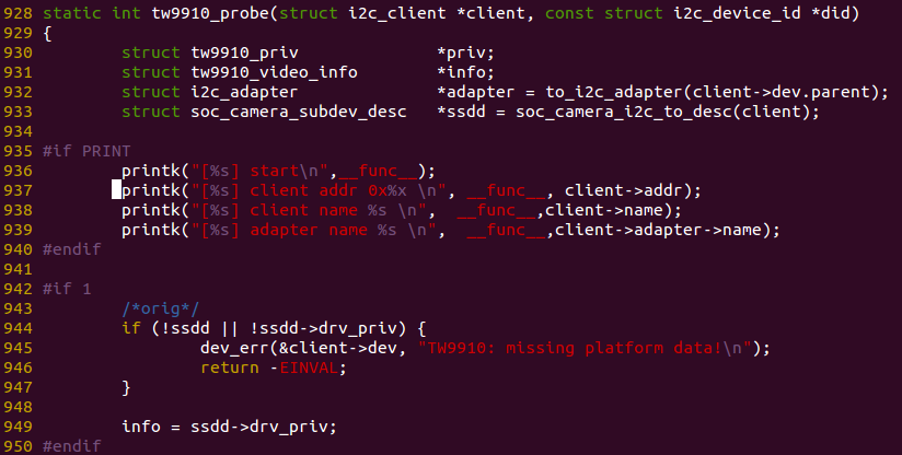

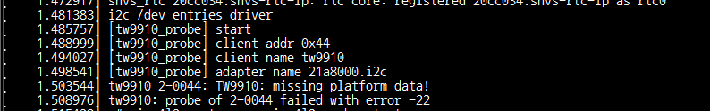

   i founded  tw9910 driver  error message.
      "tw9910 2-0044 : TW9910: missing platform data!
 It is tw9910 dirver probe source.
   I think soc_camera_i2c_to_desc(client) function returns NULL.
  Why return valuse is NULL?
   How resolve this problems??

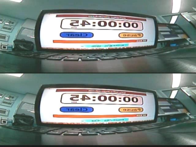

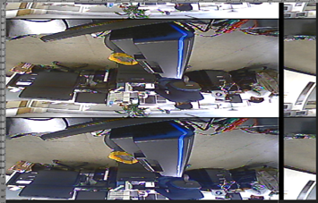

moowonlee
Hi igorpadykov
 I captured image through tw9900 on i.mx6 solox.
but There are two filed in the image.
what is the problem?
please help me

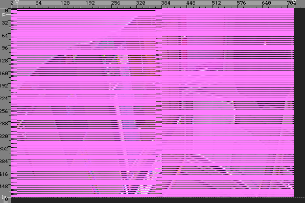

moowonlee
hi igorpadykov
thanks your help
Analog CAM  ====nstc====>Tw9900 ====BT656 =====> imx6sx CSI1
I made Tw9900 driver. and It is working
currently, I have a problem.
This picture is dumped from csi buffer Using DQueue
 when  It was  "csi_buf_stride_set(cam, 720); " "csi_deinterlace_enable(cam, false);" in csi_v4l2_catpure.c, I  dumped picture.
  when I revise  "csi_buf_stride_set(cam, 0); " "csi_deinterlace_enable(cam, false);" in csi_v4l2_catpure.c, I  dumped picture.
I think CSI driver dosen`t  find start of frame.
let me know how to resolve this problem.
and What is buf stride?
I found IMX6SX Reference Manual, but I am not understand about buf_stride.
Could you tell me more?
