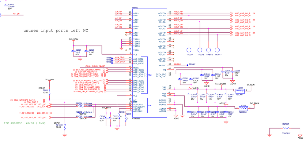

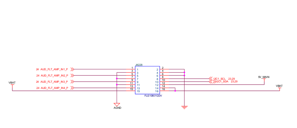

We have connected audio Amp to i2c1 on probing in u-boot we can see the address 6E of audio amplifier , but could not find any android driver on Internet to control this device through i2c .
Audio Codec CS42888 same as Sabreauto also on same cpu pins as Sabreauto
By default there is no sound when audio track is played .
I think we have to select channel and few other configuration is required to be performed for audio amplifier to work .
Is there a kernel driver required for this or ?

Hi Sooraj
seems it can be used without i2c initialization, if necessary on can add its
i2c init settings in probe function of CS42888 driver or create own driver using Porting Guide
document included in Linux Documentation on link
i.MX Software|NXP
I am not aware of TDF8546 drivers.
igor

Hello Igor ,
audio amplifier can work without any software changes ?
