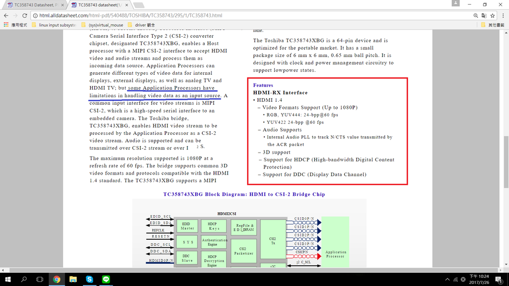

berniechen
Hi NXP
Android:6.0.1
kernel: 4.1.15
I have this issue as well, I using HiKey board as input souce(kernel detect 720P), but I found resolution of camera hal is wrong resolution, so that I can not show video at application. And I test the Udoo neo board(imx6 soloX), the kernel detect it 720p, and the camera hal gets the correct resolution, then the upper application can show video data. I refer the tc358743 datasheet frome this
http://html.alldatasheet.com/html-pdf/540488/TOSHIBA/TC358743/295/1/TC358743.html
What it means about "some Application Processor have limitations is handling video data as an input source?"
Does this case of tc358743 driver from Boundary Device only support imx6 soc has relation with HDMI-RX-Interface support format??
