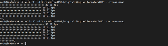

HI,
We have supported UYVY, SRGB10 formats from the camera and using iMX8MPlus kit for the evaluation.
After booting of the kit, if we first launch either UYVY or SRGB10, the stream works without any issues in the format. But when we try to switch between the format, the stream stops.
We have debugged the camera MIPI signals. It is correctly configuring with the required format and MIPI signal activity is proper in the camera.
But the iMX8Mplus platform not supporting the switching between the different formats. Is there any patches to resolve this issue?
We are using following kernel.
kernel : v6.1.55
Yocto : mickledore
Thanks.

what bsp do you use? it seems you change the source code by yourself, how about testing the default bsp? I tested on 6.6.23 bsp with os08a20 camera, I couldn't reproduce this issue

We are using v4l2-ctl to switch between formats.
For example,
After boot, first if we try to stream RAW10 format as given below, the stream works.
# v4l2-ctl -d 3 -v width=4208,height=3124,pixelformat='BA10' --stream-mmap
[ 56.755600] streamdb[0]=0, mode=8
[ 56.755618] streamdb[1]=1, mode=8
[ 56.758971] streamdb[2]=2, mode=8
[ 56.762301] streamdb[3]=3, mode=8
[ 56.765634] streamdb[4]=4, mode=8
[ 56.768962] streamdb[5]=5, mode=8
[ 56.772291] streamdb[6]=6, mode=8
[ 56.775607] streamdb[7]=7, mode=8
[ 56.778934] streamdb[8]=8, mode=8
[ 56.782265] Index = 0x0008 , format = 0x30314142, width = 4208, height = 3124, frate num = 20
[ 56.834770] input fmt BA10
[ 56.837510] output fmt BA10
<<<<<<<<<<<<<<<<<<<<<< 20.00 fps
<<<<<<<^C
root@ucm-imx8m-plus:~#
Then, I tried to stream the UYVY format as given below. But the system sets all the configuration in the platform and camera but stops without streaming. There is frame done interrupt in the platform.
# v4l2-ctl -d 3 -v width=4192,height=3120,pixelformat='UYVY' --stream-mmap
[ 96.384454] streamdb[0]=0, mode=4
[ 96.384471] streamdb[1]=1, mode=4
[ 96.387840] streamdb[2]=2, mode=4
[ 96.391173] streamdb[3]=3, mode=4
[ 96.394504] streamdb[4]=4, mode=4
[ 96.397832] Index = 0x0004 , format = 0x59565955, width = 4192, height = 3120, frate num = 13
[ 96.463186] bypass csc
[ 96.465562] input fmt YUV4
[ 96.468283] output fmt UYVY
The platform gives no error. But it is not able to receive the frames properly during the format switch. We have confirmed on the camera side that the requested format is configured and MIPI activity is proper in the camera hardware.
Kindly let us know in case any other additional information is needed.
Thanks.
