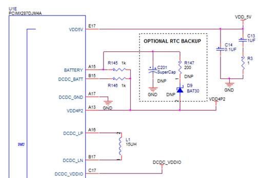

B_K_Ankur
Hello Jorge and Alejandro,
Thank you for your comments and suggestions. I agree that the wakeup thing works perfect on I.MX28EVK board. But I am facing issue with prototype having 5V power mode.
I am using u-boot to boot prototype with 5V mode. I have modified powerprep to generate library and using the same under u-boot. Find the attached patch file I uses on top of default provided.
Default Patch from Freescale:
  • 0001-MX28-imx-bootlets-adds-the-most-robust-support-for-VDD5V-only-configuration.patch
  • 0002-MX28-imx-bootlets-Fix-repeated-boot-issue-with-5V-only-configuration.patch
  • 0003-MX28-imx-bootlets-5V-only-configuration-bug-fixes-and-improvement.patch
Additional Patch:
  • 0004-MX28-imx-bootlets-add_support_for_u-boot_to_use_powerprep.patch
Using powerprep_start() function of powerprep into mxs_power_init function under spl_power_init.c of u-boot.
My only concern is, could anyone test the standby functionality on board with 5V power supply and check if that works ?
In addition, the standby thing works on prototype but not consistent. What can be the possibilities that fail to bring the micro back after certain 4-5 cycles of suspend/resume?
Following Power supply circuit is used in the prototype:
Please feel free to share your concern.
