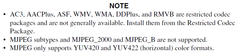

Hello community,
In Android BSP document, it have no information about support format of JPEG still image file.
Only MJPEG have little information in NOTE of iMX_Android_Extended_Codec_Release_Note.pdf.
Is it conformed to support JPEG format on MJPEG's one?
Or by default setting of Android BSP, it is using software encoder/decoder of Android for JPEG image.
So it is conformed by Android support format?
I'm using i.mx6dual and Android BSP JP4.2.2_1.1.0-ga.
Ishii.

I hope to know both encoder and decoder supported file format.
But mainly JPEG decoder.
I think that JPEG encoder is used for Photo image by Camera application.
So it will be support Eixf version ?.?? / YCbCr422 and additionally YCbCr420.
Does encoder can use YCC444 if is it specified as encode format by user programmed application?
Ishii.

vpu can handle MJPEG decoding, you can use vpu to deocode JPEG, but we suggest that you use opensource to handle this, like jpegdec, and shouldn't support EIXF, can support JFIF format
for vpu, can Support 4:2:0, 4:2:2, 2:2:4, 4:4:4 and 4:0:0 color format
