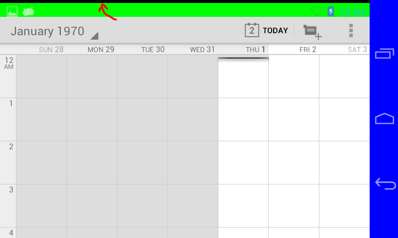

There's a strange offset on our status bar:
and the navigator bar. I changed the background colors to make it more clear. If I call getLocationOnScreen() on the StatusBarView it reports 0,0. Which clearly is wrong.
Changing the wallpaper will make it appear above the status bar until the screen is redrawn. The purple arrow points to a single line that also appears in the apps screen, but I think it's a symptom of the other error.
I'm pretty much lost of ideas. Anyone?
In landscape mode it looks like this:

Thomas, which device are you using?, is it a sabre board?, and are you using the included LVDS or a different display?

http://www.spectralink.com/pivot/
It's based on the sabre board.
If I disable hardware acceleration for the status and navigation bar the problem is gone.
2,302 Views
daiane_angolini
which hardware acceleration do you enable/disable in navigator bar to get this bug on/off? I mean 3d, 2d?
Does this happen only with LVDS? Or if you display on HDMI you can reproduce the same behavior?
