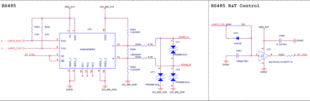

weidong_sun
    RS485 is a half duplex communication mode. The key to the design of UART to RS485 is how to control the direction of receiving and transmitting data.
    The above imx.c supports two control modes: GPIO or UART CTS.
For example, see circuit below, please!
---GPIO
You can use GPIO to control the level of DE/ RE# pin to determine whether data is received or sent on the bus.
This method is difficult to guarantee performance, because there must be necessary delay time between TX and RX.  This time is controlled by software. In fact, you can also use this GPIO to control IO direction in application layer software.
---UART_CTS
UART_CTS pin controls IO direction, which may have better performance than GPIO mode, but it also depends on software to determine when TX ends or RX ends. There is always a delay.
---Hardware controls IO direction
The following circuit is using UART_TXD's level feature to control IO directory automatically,No software is needed to control IO direction.
I hope the above explanation will help you!
Have a nice day!
BR,
Weidong

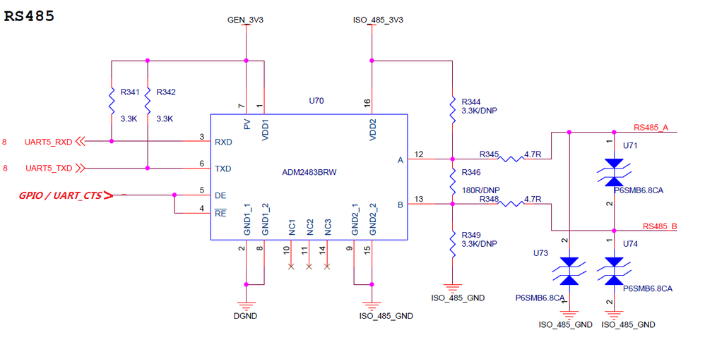

apollo_chen
Dear Weidong,
I would like to know this circuit can work well with RS485. Becuase RS485 module's supply is 5V, and i.MX8MQ UART(TX/RX/RTS/CTS) is 3.3V.  And We find the voltage level is 4.75V on UART's pads. Could you please kindly help to check the circuit? Because we are facing timeout problem.
Apollo

weidong_sun
---GPIO
---UART_CTS
Have a nice day!
BR,
Weidong
