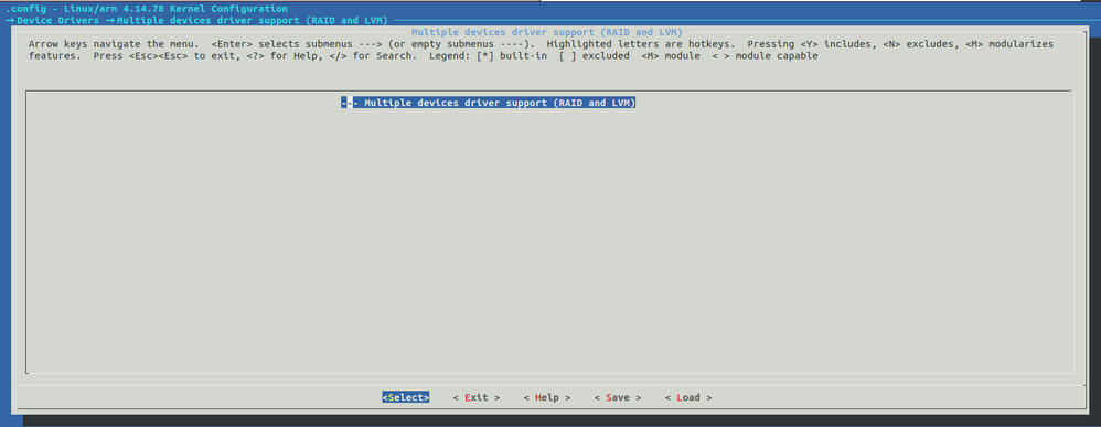

tomasklein
Hi, Thank for you advice.
If I go to the defconfig, I do not have any of this configs option:
    CONFIG_BLK_DEV_DM=m
    CONFIG_DM_DEBUG=y
    CONFIG_DM_CRYPT=m
I am using kernel version 4.1.44-fslc and yocto 2.4 Rocko.
Is there any other option how to enable DM Crypt ?
Thank for any advice or ideas :smileyhappy:
Tomas Klein
15,332 Views
marouene_boubakri
Run
bitbake -c menuconfig virtual/kernel
Enable the Kernel to support Device Mapper and Crypt DM target.
Device Drivers --> RAID and LVM Support -->
[*] Multiple devices driver support (RAID and LVM)
<*> Device mapper support
<M> Crypt target support
Exit and save your config.‍‍‍‍‍
Enable the Kernel to support initrd and RAM block devices.
General setup --->
 [*] Initial RAM filesystem and RAM disk (initramfs/initrd) support
 () Initramfs source file(s)
[*]   Support initial ramdisk/ramfs compressed using gzip
Device Drivers --->
[*] Block devices --->
 <M> RAM block device support
 (16) Default number of RAM disks
 (16384) Default RAM disk size (kbytes)‍‍‍‍‍‍‍‍‍
Maro
15,332 Views
tomasklein
Problem is that, in menu-config I do not have option to enable the device mapper support or crypt target support as you can see in screenshot.Screenshot from 2019-03-04 10-49-59.png
Tomas.

kanimozhi_t
Contributor V
    Though your comment is aged I like to add my inputs here: You need to open menuconfig and press enter on "Device drivers" and you need to press y to include "Multiple devices driver support (RAID and LVM)" to include the module and press enter to access its options (Device mapper support & Crypt target support).
You can find the instructions on top of the menuconfig.
