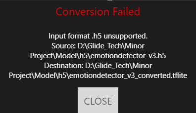

I am facing one more issue that I have my custom model which is right now in the H5 format. But I used EIQ Portal for converting this model into the tflite format and after using Neutron Converter I want to deploy that model on the IMX95 NPU Board.
But I am facing this error.
In that they mention that h5 format is not supported but in the user guide mentioned that h5 will support as Input.
Here I attached my model file as well. Please look and please guide me where is the issue?image.png
