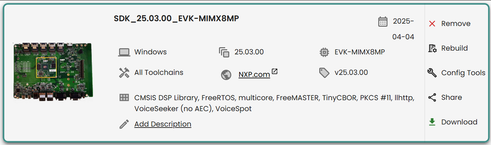

JorgeCas
Voice Intelligent Technology (VIT) library and voice control software package is delivered via the MCUXpresso SDK or Linux BSP.
When you choose SDK library, you need choose VoiceSpot and VoiceSeeker.
For VIT User Guide, you can find it in the next link. Also, please refer below website and download Low Power Voice UI Demo.pdf
Best regards.
