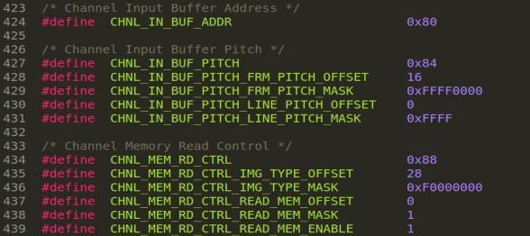

Latest reference manual (IMX8DQXPRM.pdf Rev.0) mentioned following steps which copying image data from memory to ISI module. However, several registers have been missed in register memory map. Are CHNL_IN_BUF_ADDR, CHNL_IN_BUF_PITCH and CHNL_MEM_RD_CTRL registers remaining in latest device (C0 rev)?
I think it is a typo. Will it be revised in nearly future?

• Configure the memory address from where the image is to be sourced in the CHNL_IN_BUF_ADDR[ADDR].
• Configure the line and frame pitch in the CHNL_IN_BUF_PITCH register.
• Configure the read image format in the CHNL_MEM_RD_CTRL[IMG_TYPE] field.
• Complete the initialization of other blocks and interrupts for channel 0 and set CHNL_CTRL[CHNL_EN] = 1.
• Set the CHNL_MEM_RD_CTRL[READ_MEM] = 1 to enable reading of frame from memory.
• Wait for CHNL_STS[MEM_RD_DONE] interrupt to set before initiating a new image read.
  When this interrupt occurs, set CHNL_MEM_RD_CTRL[READ_MEM]
Copy from latest reference manual (Rev.0)
Copy from old reference manual (Rev.E)
Linux BSP definition (L4.14.98_2.3.0_ga / mxc-isi-hw.h)

   it appears these registers have been removed by mistake, will log this and they should
be added back in to the next version.

Hi Yuri,
I appreciate your support. I got it.
