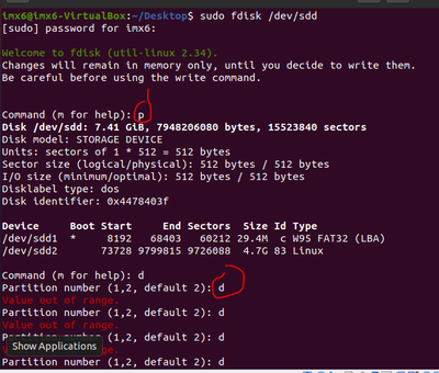

The following figure:when I type the  sudo fdisk /dev/sdx, and then type 'p',next type 'd',But when I keep typing d,Linux gave me the same tip.In that case, how am I going to finish p -d -n -p -l -20480...-w
Or I can't read the Linux prompts.
So I can't go back to the document.

Hello guojpf,
You need to download to SDCARD, you are doing the procedure to HDD, the Sdcard should be /dev/sda or sdx, the rest of image creation is ok.

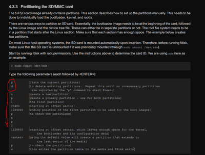

So what should I do in section 4.3.3? Follow the document step by step but it doesn't work。 Am I typing instructions from the document?
1,754件の閲覧回数
Bio_TICFSL
Yes it works but it refer to sdX where the X is the label that your operating system get to SDCARD in this case should be sda or sdb.
