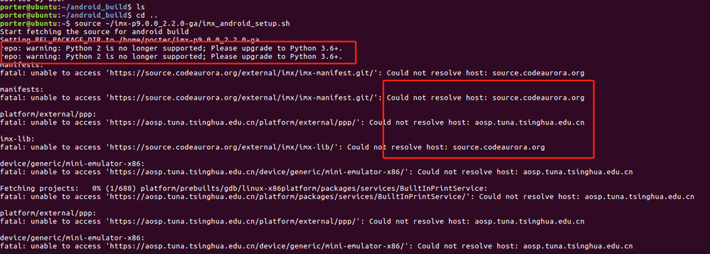

I used Vmware 12 and Ubuntu 16.04 LTS to test and check these contents step by step, but still met some problems when i do the operation: source ~/imx-p9.0.0_2.0.0-ga/imx_android_setup.sh,
The failure has been reported like: Could not resolve host: source.codeaurora.org.
it also reminded:  Python 2 is no longer supported; Please upgrade to Python 3.6+.
"repo sync" again also can not help, could you guys please help check them and give me some guides?

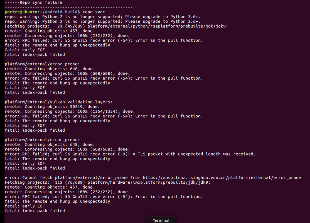

1. It will report errors like "RPC failed; curl 56 GnuTLS recv error(-9): A TLS packet with unexected length was received." or "curl 56 GnuTLS recv error(-54)" or  "curl 56 GnuTLS recv error(-110)" when I input the "source ~/imx...." CMD. Even I ignored these errors, still input "repo sync" again, but sitll repo sync failure.
2. Sometimes, it reported "curl:(35) gnutls_handshake() failed:Handshake failed".
3. I have debug issue1 and issue2 on internet, someone said it needs to update 'libcurl4-openssl-dev' to replace 'libcurl4-gnutls-dev', and use 'dpkg -i ../git_1.9.1_amd64.deb' to install git. But i also met a problem that 'sudo dpkg-buildpackage -rfakeroot -b' is not work, it will report errors about 'debian/changelog', please check followed picture.

it seems the server has issue for downloading, not your settings issue, what board do you build? P9.0.0_2.2.0 is for imx6, if you confirm you need this let me try to send the source code to you

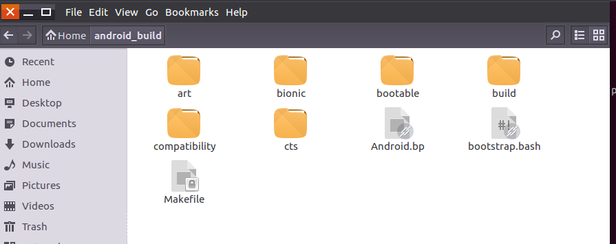

Hi Joan, sorry for the reply late, just finished the downloading of the source code, and i have a doublt that i don't know which content in android_build folder needs to be replaced, some parts or all? i made some screenshots, could you please help?
1,966 Views
joanxie
just unzip the source code downloaded from the link I sent to you, then copy all of them into the folder android_build

it seems that this is network issue, check your proxy or network,  maybe you can try more times, maybe the server isn't stable enough, it seems that you have changed to tsinghua already
1,966 Views
946846828
Hi Joan,
yes, you are right, i have found this issue, changed to another network, it works.
but i still met a problem, it always showed failed when I inputed 'repo sync'. how to debug this issue?

Have you checked the comment section in the https://community.nxp.com/docs/DOC-343242  which describes "
  • [Comment]For android 9.0.0_2.2.0, customers can try to do a little change on the following steps:"

thanks for your reply, i have checked the steps, and found this is a network issue, but i met other issues, please comment it if you convenient.2.png
1,966 Views
karangajjar
Senior Contributor II
Hi chu zhongbo,
This also seems to be network issue.
