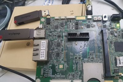

We have two Udisks with 128GB and 64GB. Both two can be enumerated in the MX8MP-EVK evaluation board. The 64GB can be  enumerated in MCIMX6ULL-EVK evaluation board, but the 64GB not.
Both of NXP's demo firmwares L4.1.15_2.0.0 and L5.4.24-2.1.0_images_MX6UL7D in MCIMX6ULL-EVK evaluation board can reproduce this issue.
The following is the test log on the MCIMX6ULL-EVK Evaluation Board:

root@imx6ul7d:~# try 64gb udisk, awlays fail

root@imx6ul7d:~# change 128gb udisk, always sucess

root@imx6ul7d:~# retry 64gb udisk, always fail

Except for the Udisk, both the hardware and software are from NXP. What could be the root cause of this issue?
91件の閲覧回数
machangbao
The root cause of the issue is that this 64GB Udisk cannot properly backwardly compatible with USB 2.0.
2 返答(返信)
92件の閲覧回数
machangbao
99件の閲覧回数
machangbao
Correction for a typo: The 128GB Udisk can be enumerated in MCIMX6ULL-EVK evaluation board, while the 64GB Udisk cannot.
Additional Information: Both of the aforementioned Thinkplus Udisk are  products of the Lenovo brand. As shown in the figure below:
