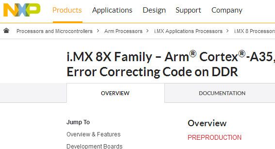

2. i.MX8QXP is not publicly released yet, it is marked as "PREPRODUCTION" as shown below
and also has not full support.
igor
