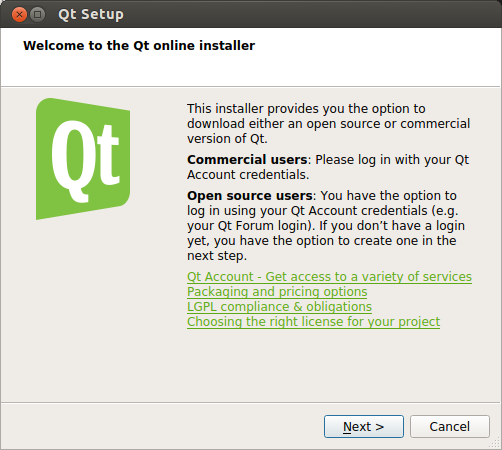

Then run the installer
$ ./ qt-unified-linux-x64-2.0.2-2-online.run

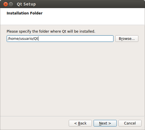

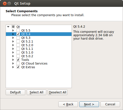

After the information from the repositories has been fetched you will be asked where to install Qt Creator.

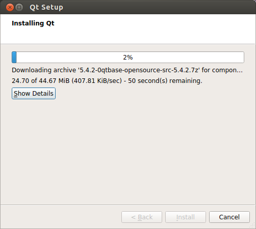

Then you will be asked which components to install. We will install Qt 5.4 which is the one supported on the 3.14.28 BSP release.
You will need to accept the License Agreement and then the installer will fetch and install the necessary files.

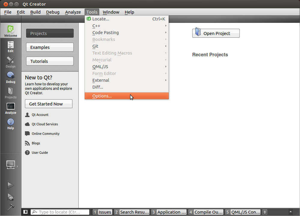

Under the Tools top bar menu, chose Options…

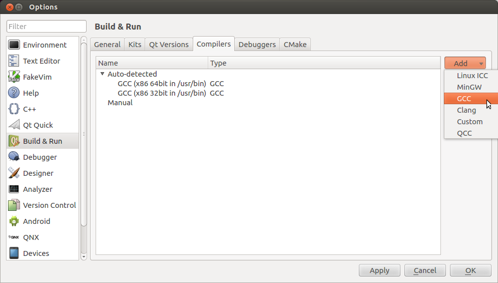

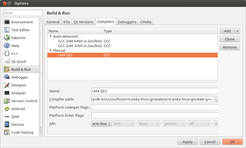

On the Options window’s left menu chose Build & Run and then the Compilers tab and select Add GCC.
On the next screen chose a name for this Compiler (i.e. i.MX Qt5) and then select the Compiler path, which may vary depending on where you have it installed but by default should be in:
/opt/poky/<VERSION>/sysroots/x86_64-pokysdk-linux/usr/bin/arm-poky-linux-gnueabi/arm-poky-linux-gnueabi-g++
It should then be detected as arm-linux on the ABI section.

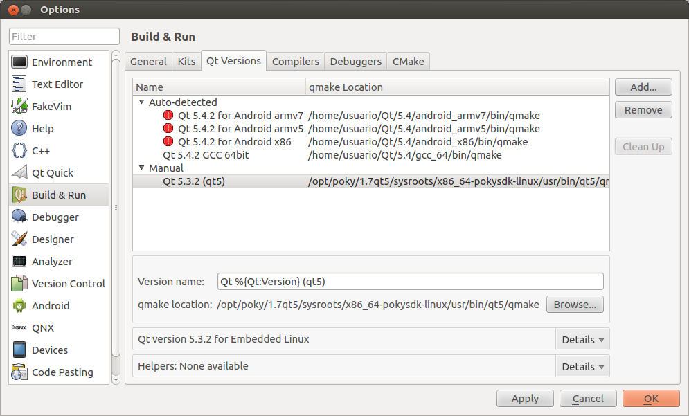

Next select the Qt Versions tab and click on Add… Look for the qmake on the toolchain path, which is by default:
/opt/poky/<VERSION>/sysroots/x86_64-pokysdk-linux/usr/bin/qt5/qmake

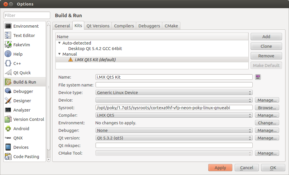

Finally, on the Kits tab add a new kit and select the sysroots from the toolchain, which is by default located in:
/opt/poky/<VERSION>/sysroots/cortexa9hf-vfp-neon-poky-linux-gnueabi
Qt Creator is now configured for building for the i.MX6.
