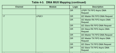

HELLO!
I am attempting to set up DMA that will be used by multiple i2c buses (lpi2c1, lp12c2, ...) on a RT1062.
Wondering what would be the appropriate way to set up the handles via...
  • LPI2C_MasterCreateEDMAHandle(LPI2C_Type *base,
    lpi2c_master_edma_handle_t *handle,
    edma_handle_t *rxDmaHandle,
    edma_handle_t *txDmaHandle,
    lpi2c_master_edma_transfer_callback_t callback,
    void *userData)
  • EDMA_CreateHandle(edma_handle_t *handle, DMA_Type *base, uint32_t channel)
Can each individual i2c interface have its own set of handles and which handles are these?
I cannot seem to find an example in MCUXpresso for this type of setup.
May anyone please help?
Thank you!
-Ka
1,019 Views

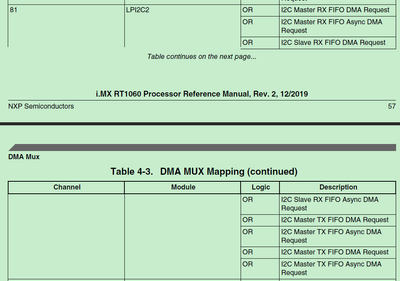

Hui_Ma
Please also need to initialize the DMAMUX for LPI2C1 & LPI2C2 accordingly.
Wish it heps.
Mike
