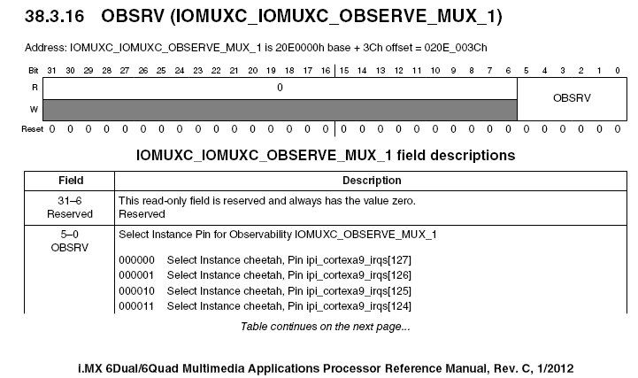

#define MX6QDL_PAD_GPIO_6__ENET_IRQ         0x230 0x600 0x03c 0x11 0xff000609
So my question is what is the 0x03c SELECT_INPUT register since I don't find it in the reference manual?

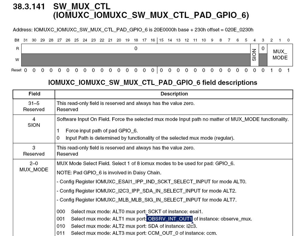

igorpadykov
Hi Roberto
according to ERR006687 erratum interrupts can be selected by MUX and outputted
to pad GPIO6 using special  IOMUXC_OBSERVE_MUX_1 register (used for
debugging purposes), its address offset is 3Ch. Unfortunately output of this
register can be muxed only on GPIO_6 pad.
igor

The errata ERR006687 you posted is referencing to workaround when the system enter in Wait mode hence will not get wakeup in case of ENET RX/TX traffic because the GPC doesn't see the interrupt.
If I set SION bit to GPIO1_26 wired to ksz9021 INT_N pin, I'm getting this kernel backtrace, should I set manually the direction of the GPIO instead to use SION bit then?
