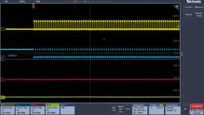

I'm trying to send bytes over ecspi using spidev and from a certain number of bytes, the chip select toggles every bytes.
Up to 64 bytes, there is only one chip select level change and from 65, CS is toggling on every byte.
Below capture when I send less or equal to 64 bytes :
Below capture when I send more than 64 bytes :

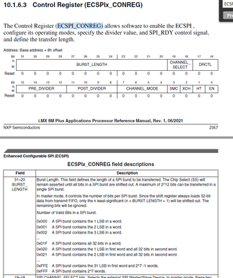

Regarding the reference manual, we can use the ECSPIx_CONREG :
My question is : where can I set this value in Linux kernel?

For short transfers (less than FIFO size), the ECSPI driver always uses PIO transfers, regardless whether you have configured (S)DMA for this ECSPI instance in your device tree (see spi_imx_can_dma()). For larger transfers, SDMA may be used.
For PIO transfers, the driver implements a feature called "dynamic burst". The drivers tries to set the burst length to the number of bytes x number of bits per byte (e.g. 8). This brings a better performance as it avoids having small delays between each byte.
For the SDMA case, the dynamic burst feature is not implemented yet. So for DMA transfers, the ECSPI driver seems to use a fixed burst size (e.g. 8 bit). This introduces small delays and a CS toggle between each byte. You can probably avoid this by configuring CS as a GPIO. The ECSPI driver supports either controlling the CS pin in "ECSPI mode" or "GPIO mode". Actually this depends only on your device tree configuration, you can use the same physical pin for this.
Conclusion: Although using DMA should generally bring a better performance, for the ECSPI case the PIO case may be more suitable for you (due to the "dynamic burst" feature). You have the following options:
  1. Configure the ECSPI in your device tree for using CS in GPIO mode.
  2. Disable SDMA for this ECSPI instance in your device tree
  3. Implement "dynamic burst" for DMA transfers. This would need adaption of the Linux driver and the SDMA firmware.

As @kef2 metioned, the answer is yes in imx-linux/drivers/spi/spi-imx.c you can find the function spi_imx_set_burst_len and you can set the burst for this communication protocol.

Yes, it is annoying when someone renames documentation terms and uses his own in public code without any dictionary provided. At least they could mention it in comments to magic defines:
#define MX51_ECSPI_CTRL_BL_OFFSET 20
#define MX51_ECSPI_CTRL_BL_MASK (0xfff << 20)
spi_imx_set_burst_len() function setups BURST_LENGTH
  1. Regarding issue you see. eCSPI provides 64 x 32bits FIFO. Which is enough to transfer message of up to 256 bytes without any intermediate interrupts or DMA involvement.
  2. BURST_LENGTH allows up to 512 bytes messages (4096 bits). It means you can automate leading and trailing CS toggle only for messages, which fit BURST_LENGTH limit.
  3. As I understand someone decided that automatic CS function is less important than unlimited message length served by DMA and GPIO-CS toggled by CPU. That's perhaps good idea to use eCSPI with flash memories. But why one would use eCSPI for flash when there's dedicated QSPI, which supports not only 4/8bit data per clock, but as well simple 1bit /clock memories?...
  4. Sending messages, which are not multiple of unit32_t, remainder 1-3 bytes have to by pushed to FIFO first, not at the end of transfer. Perhaps someone was to lazy to create SDMA script, which would handle odd length transfer. I think for simplicity they decided to instead send multiple of bits-per-word messages. As you know, SPI on Linux supports 8/16/32 bits per word transfers. That turns to up to 64x8 / 64x16 or 64x32 transfer without DMA and without CS toggle between bits-per-word items. Above that limit you see multiple of 8 / 16 / 32 -bit transfers with CS toggles.
If you don't need very long SPI messages, then try disabling SPI DMA.
