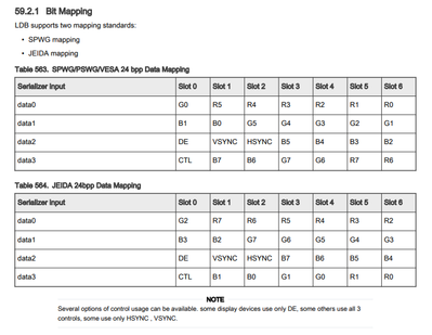

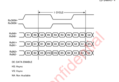

michal_hromadka
Hello @aditya_h ,
Your LCD panel does not seem to be compatible with the  LVDS Display Bridge. The panel supports RGB data via 3 of the 4 LVDS lines instead of the 4 lines supported by the i.MX93.
EDIT: The LCD is compatible if you omit the data3/RxIn3 line and switch the i.MX93 to JEIDA mode which maps the LSB RGB bits to this line (see below).
LCD panel input:
 i.MX93 LVDS output:
Michal

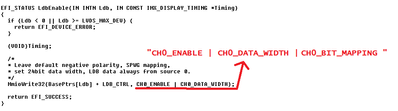

michal_hromadka
Hello @aditya_h ,
We were able to simulate the color issue by switching the display to 6-bit mode. After switching from the default SPWD data mode to JEIDA, the colors were fixed.
Please try to make the changes in the file as shown below:
File: <BSP>\mu_platform_nxp\Silicon\ARM\NXP\iMX8Pkg\Library\iMX8LcdHwLib\iMX9xLvds.c
Please let us know if this changes helped you.
@Naveen_V_M, We have been able to fixed the issue by changes above.
Michal
