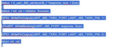

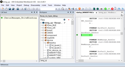

I'm getting a serial write manager hard fault error. This error I'm getting if I write multiple times in UART using LPUART_WRITE_BLOCKING Api's.
Here is my code snippet.
When I'm getting a hard fault error, I can only receive 5 bytes.

Hello @yalin_10,
Could you please use GPIO_PinWrite() instead of GPIO_WritePinOutput() as this function is deprecated?
Also, did you receive an error window? Did the program stop when you receive only 5 bytes? Or the communication continues? In case you receive an error window, or the program stops while debugging, could you please share them with us?
Finally, could you please make sure you are sending one character at a time? For example, in the lpuart_polling example if you input/send too many characters each time, the receiver may overflow.

yalin_10
Yes my program stops after receiving 5 bytes.

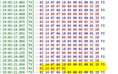

yalin_10
1, No change in the result after we change the API's
2, consistent failure happens every time I send 3 frames, each frames having 15 bytes. even if I send once in one minute.
our device is MIMXRT1062.
We are using FreeRtos

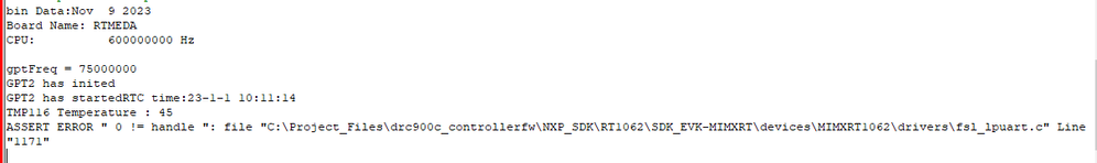

yalin_10
I tried one more method using Freertos-Uart Apis
#define RT_LPUART 											  LPUART7
#define RT_LPUART_CLK_FREQ 								BOARD_DebugConsoleSrcFreq()
#define RT_BAUDRATE										    9600U
#define RT_LPUART_RINGBUFFER_SIZE					120U
lpuart_rtos_handle_t rt_rtos_uart_handle							= {0};
lpuart_handle_t rt_uart_handle										= {0};
lpuart_rtos_config_t rt_uart_cfg									= {0};
uint8_t uart_rtos_buffer[RT_LPUART_RINGBUFFER_SIZE + 1]			= {0};
status_t Init485Uart(void){
  rt_uart_cfg.srcclk 		  = RT_LPUART_CLK_FREQ;
	rt_uart_cfg.baudrate 		= RT_BAUDRATE;
	rt_uart_cfg.base 			  = RT_LPUART;
	rt_uart_cfg.stopbits		  = kLPUART_OneStopBit;
	rt_uart_cfg.parity			  = kLPUART_ParityDisabled;
	rt_uart_cfg.buffer			  = (uint8_t *)uart_rtos_buffer;
	rt_uart_cfg.buffer_size	= RT_LPUART_RINGBUFFER_SIZE + 1;
	/*call the HAL UART init function from HAL section */
	return LPUART_RTOS_Init(&rt_rtos_uart_handle, &rt_uart_handle, &rt_uart_cfg) ;
Getting Assert Error as handle is Null which is very weird because it is already declared.
So, I am at a fix now could not proceed in any direction.
