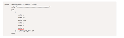

I generated the keys as:
pushd ./secure_boot/CRT/cst-3.3.2/keys
        echo "======================================"
        pwd
                echo n
                echo rsa
                echo 1024
                echo 15
                echo 4
                echo n
            ) | ./hab4_pki_tree.sh
        popd

Harvey021
Hi @mariusoctavian
It seems that you did "Generating a fast authentication PKI tree", is that right?
Harvey

mariusoctavian
What 'Generating a fast authentication PKI tree' suppose to  mean.
I was following pretty much:
https://community.nxp.com/t5/i-MX-Processors-Knowledge-Base/Steps-to-enable-secure-boot-in-i-MX8M-Na...
Is there a better paper? . I am not using yocto. I have build everything on build-root. Is cleaner and faster,
though I see NXP went all the way with yocto.
I did not burn the fuses yet. I did not do anything with the filesystem and kernel.
OS Already flashed in the emmc partition 1

What 'Generating a fast authentication PKI tree' suppose to  mean?
I see this from your post
Harvey
4,983 Views
mariusoctavian
That was answer to:
Do you want the SRK certificates to have the CA flag set? (y/n)?
4,982 Views
mariusoctavian
Do you want the SRK certificates to have the CA flag set? (y/n)?:
            echo n
            echo rsa
            echo 1024
            echo 15
            echo 4
            echo y  # Do you want the SRK certificates to have the CA flag set? (y/n)?: y
answering yes did not changed a thing.
