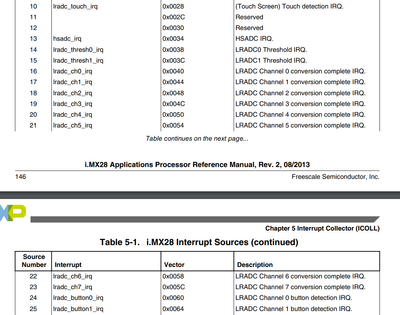

Now it appears the irq name is missing on device tree.
Please try adding:
lradc: lradc@80050000 {
    compatible = "fsl,imx28-lradc";
    reg = <0x80050000 0x2000>;
    interrupt-parent = <&icoll>;
    interrupts = <10 14 15 16 17 18 19 20 21 22 23 24 25>;
    interrupt-names = "mxs-lradc-touchscreen", "mxs-lradc-thresh0", "mxs-lradc-thresh1",
                      "mxs-lradc-ch0", "mxs-lradc-ch1", "mxs-lradc-ch2",
                      "mxs-lradc-ch3", "mxs-lradc-ch4", "mxs-lradc-ch5",
                      "mxs-lradc-ch6", "mxs-lradc-ch7",
                      "mxs-lradc-button0", "mxs-lradc-button1";
    status = "okay";
    fsl,lradc-touchscreen-wires = <4>;
    fsl,ave-ctrl = <4>;
    fsl,ave-delay = <2>;
    fsl,settling = <10>;
Added according to the Reference manual:
And driver:
Salas.

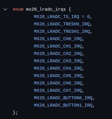

Same crash log  @Manuel_Salas .
I see in general driver (drivers/mfd/mxs-lradc.c) the enum is
enum mx28_lradc_irqs {
        MX28_LRADC_TS_IRQ = 0,
        MX28_LRADC_TRESH0_IRQ,
        MX28_LRADC_TRESH1_IRQ,
        MX28_LRADC_CH0_IRQ,
        MX28_LRADC_CH1_IRQ,
        MX28_LRADC_CH2_IRQ,
        MX28_LRADC_CH3_IRQ,
        MX28_LRADC_CH4_IRQ,
        MX28_LRADC_CH5_IRQ,
        MX28_LRADC_CH6_IRQ,
        MX28_LRADC_CH7_IRQ,
        MX28_LRADC_BUTTON0_IRQ,
        MX28_LRADC_BUTTON1_IRQ,
Here we are creating a resource structure using the string and mapping the irq
static struct resource mx28_touchscreen_resources[] = {
        DEFINE_RES_MEM(0x0, 0x0),
        DEFINE_RES_IRQ_NAMED(MX28_LRADC_TS_IRQ, "mxs-lradc-touchscreen"),
        DEFINE_RES_IRQ_NAMED(MX28_LRADC_CH6_IRQ, "mxs-lradc-channel6"),
        DEFINE_RES_IRQ_NAMED(MX28_LRADC_CH7_IRQ, "mxs-lradc-channel7"),
And in the driver (drivers/input/touchscreen/mxs-lradc-ts.c)
static const char * const mxs_lradc_ts_irq_names[] = {
        "mxs-lradc-channel6",
        "mxs-lradc-channel7",
platform_get_irq_byname(pdev, mxs_lradc_ts_irq_names[i]); in this driver trying access the irq assigned but it is assigned with '0'.
I see this function "platform_get_resource_byname" instead of platform_get_irq_byname works. Does changing of function has any impact with the screen freeze? since normally we are getting the interrupt and works fine on some occasions as mentioned earlier.
