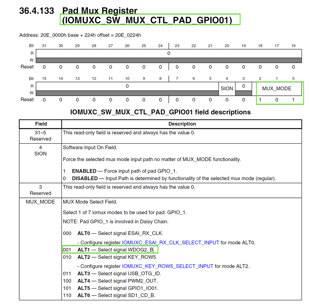

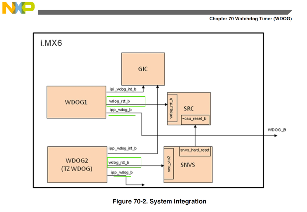

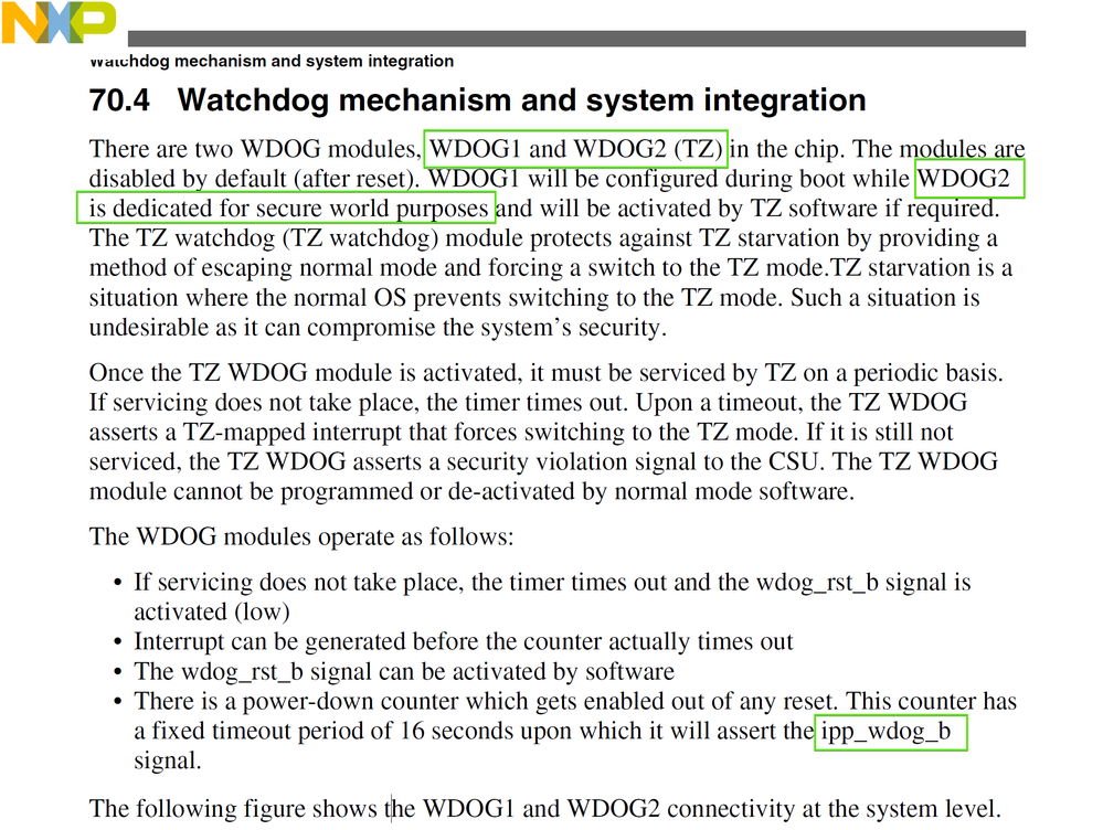

@hafizabdul_kari , for the i.MX6Q/DL, there are 2 watchdogs, named wdog1 and wdog2. But the 2 wodgs are a little bit different.
The following information From the RM: only wdog1 connected with SRC and then result in Software Reset of the chip. Both wdog1 and wdog2 can toggle the WDOG_B pin. If the WDOG_B pin on the PCB board connect with PMIC, it can trigger the system reset. On i.MX6Q SabreSD board, the WDOG_B (wdog2)  connect with PMIC, so if you want to use WDOG_B(wdog2) to trigger the reset, please configure the iomux IOMUXC_SW_MUX_CTL_PAD_GPIO01 to enable the WDOG2_B in u-boot. With NXP default BSP, the U-Boot uses the WDOG1 Software reset.

xinyu_chen
Basically, the WDOG can only be configured once after reset, some of the registers like WDE/WDW is write-once bit. So, customer must configure the WDOG in uboot, but keep configure registers untouched during kernel boot, and do not suspend/disable WDOG in uboot.
Also, WDOG_B reset signal is another consideration if customer board use it. WDOG1/2 has different external reset pin, need re-configure for their cases.
