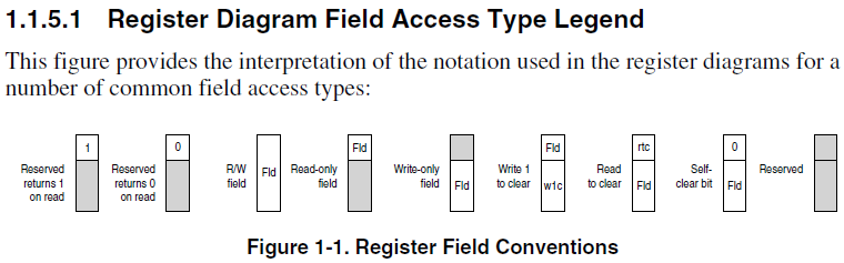

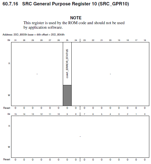

Q1. According to the RM described SRC_GPR10[core1_ERROR_STATUS] bit is read only as following figure. Is it right?
Q2. Should we clear SRC_GPR10[core1_ERROR_STATUS] field by our self? Do we need writing 0 to this field?

igorpadykov
Hi Kazuma
this bit is used exclusively by ROM and since ROM sources are not available
for customers, no more details are available regarding this bit, sorry.
Please review below part of Reference Manual description below:
NOTE
This register is used by the ROM code and should not be used
by application software.
